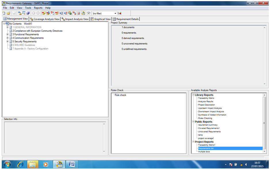

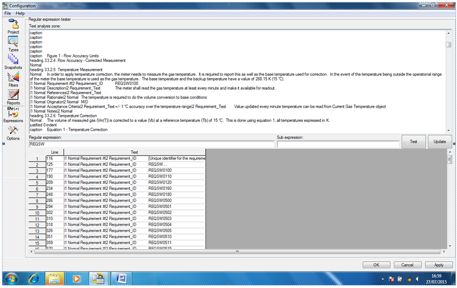

I have created a basic Regular expression in the Types area. The test of this expression shows requirements are found but when I Update and check the Management view the Project summary does not update.
Probably something simple but it has stopped me getting any further.  Any tips?

Hi Max,
I’m Scott one of the Applications Engineers at NI and I’ve been having a look into your issue. I am having trouble replicating the problem and I had a few questions, if you don’t mind.
Could you tell me which version of Requirements Gateway you are using please?
Would you be able to send me the project you are working on, in order to see whether I can replicate the issue? Just a subset of the requirements document may be sufficient to replicate the problem.
Hopefully we can get this issue resolved for you.
Feel free to PM me the files.
Thank you,
Scott
(4,168 Views)
Thanks Scott,
Putting brackets around the expression has fixed the problem. I didn't understand grouping when I wrote this message.  Thanks for getting back to me.
Max
