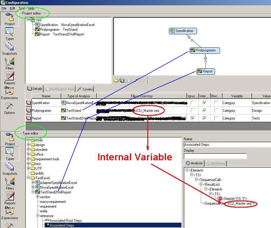

If you do not like to explain it, you have tell NIRG the name of the matching sequencefile. Just see the screenshoot.
Now i wonder is there a possibility to exchange a variable from one type to another one ?
With this feature i am able to make a NIRG Template, where the user has to enter only the files in the Project editor and the Type editor do not care.

Just see the screen shoot.
There should be a way in the TypeEditor to store a value in as named global variable.
and it should be possible to use this variable in every NIRG's type.

Unfortunately, the items in an XML type currently support only plain text or regular expressions.  You cannot use variables or any scripting for this field.  However, you may be able to get the functionality you are looking for using a filter.  If you can send a sample project using your custom types, I will look into a possible way to filter out the coverage links that do not target a requirement
