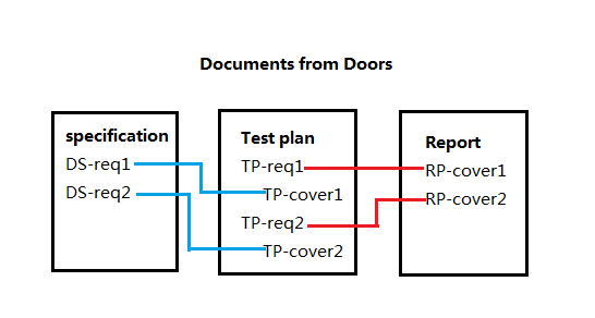

I've 3 documents in Doors need to do requirement coverage analysis.
the relationship between them shows in below picture.

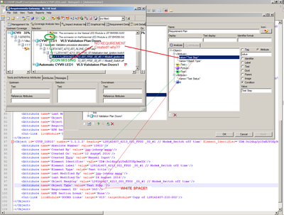

Hi Johnny,
It seems there is a whitespace that makes troubles.

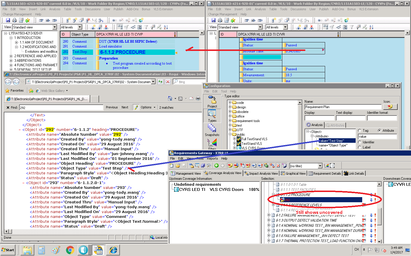

I already modify the Object type without space like below picture, but seems issue remains.
(3,850 Views)
