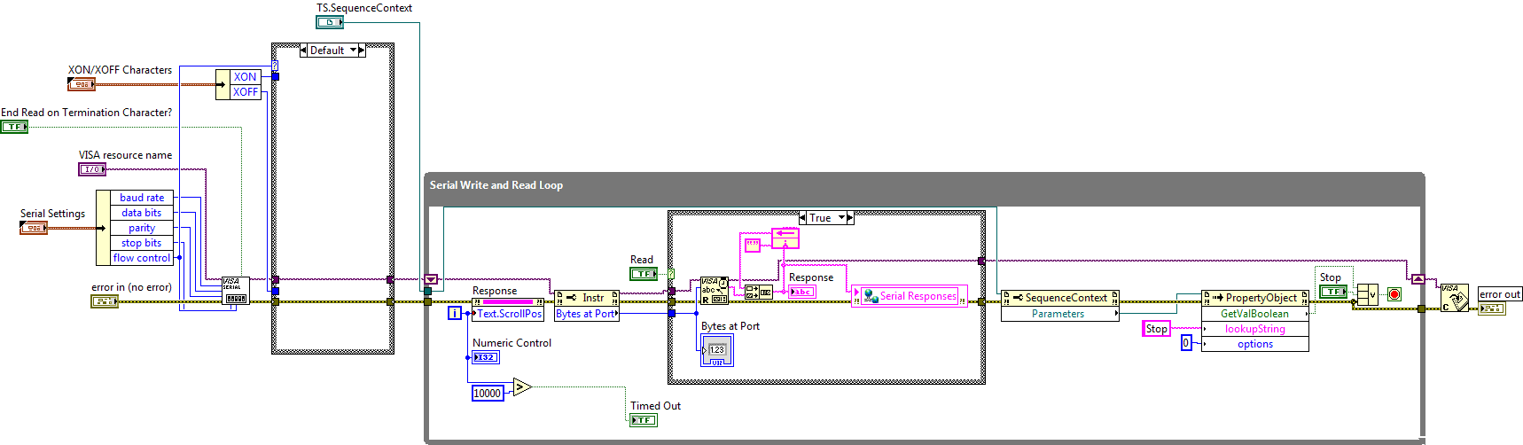

I have recreated this example originally posted on 8-6-2012; which is also found at https://decibel.ni.com/content/docs/DOC-21743.
I am having difficulty "stopping" the VI that is running asyncrhonously in another Thread.  It often times will execute the VI in the background, and other times it will give me an error:
"Unknown variable or property name 'Stop'. in Filename.vi-> Filename.vi.Proxy Caller"
Error Code: -17036; Unknown Variable or Property name.
If it doesn't give me any error, and executes properly, it won't stop  with the f(x) statement of "Parameters.Stop = True"

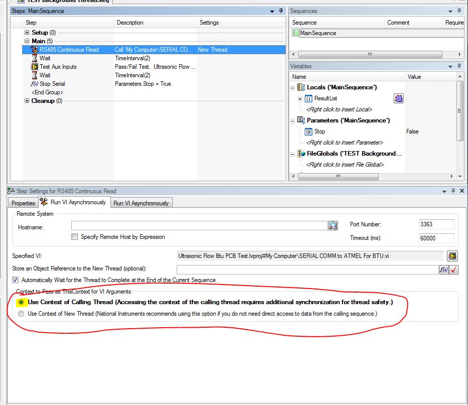

Hello again,
I have found a solution in the issue I was having.  There is a selectrion in the Run VI Asynchronously Step Settings window.  The Default Radio Button for "Context to Pass as ThisContext for VI Arguments" is "Use Context of New Thread....."
By Selecting the other Radio Button, "Use Context of Calling Thread....."  it seems to now work.  However, I will now have to look into the "Accessing the context of the calling thread requires additional synchonization for thread saftey.)
