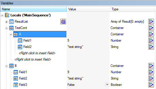

In this case scenario is I'd like to copy the container B into container A but for the A cointeners' subproperties do:
  1. if A subproperty exists, but the subproperty exists in B container and their values are equal - do nothing
  2. if A subproperty exists, but the subproperty exists in B container and their values are not equal - retain value held by A (destination)
  3. if A subproperty doesn't exist but the subproperty exist in B container - create subproperty from container B in container A along with B's subproperty value.
Is it possible wthout iterating subproperties over in the subsequence?

Unfortunately I don't know of a way to do it other than iterating.  Do you need to recurse through the hierarchy?
Here is your sequence modified to iterate through and copy them over.
Hope this helps,
jigg
