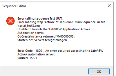

my motive is to test the serial data from Labview VI and call the VI via TestStand.
TestStand is unable to close the VI and exract serial data.
Here is th error

That is looking more like an adapter issue.  Make sure you have LabVIEW or the LabVIEW RTE installed and configure the LabVIEW adapter to point to the right version of LabVIEW or the RTE.
