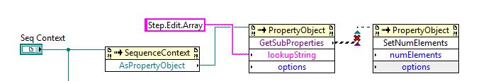

I was thinking the same thing but I don't know how to do it.
This is my failed attempt.  Can you explain what I've done wrong?

Hello MickF,
I think it would be helpful if the post knew in what context your were calling this in (e.g. OI, Code Module, etc.).
As for what is going on with your code I'm unsure if you can call "SetNumElements" by plugging in "GetSubProperties". From a LabVIEW perspective it looks like "GetSubProperties" is a variant arrary (because of the thicker purple line) of some sort and it is trying to be passed into a terminal for property object reference (thin green line). So moving forward you might have to look into how to get the  property object reference (thin green line) of the array and pass that into the SetNumElements method.
Could you show us where the arrary is the variables pane during runtime to give us a better idea of what we could do to first get it in LabVIEW, and then manipulate it.

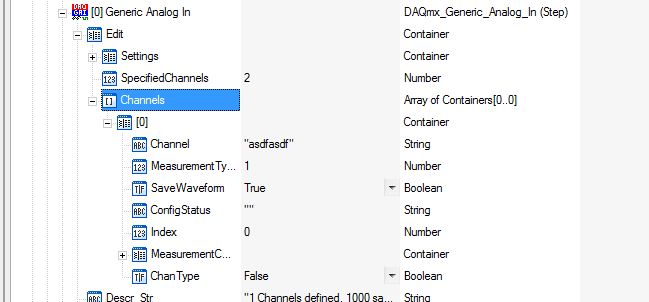

That is exactly the question.  How do I get a reference to the array to pass into the SetNumElements?
I know I can set the values of any particular variable using the SeqContext I've already passed in.  For instance the SetValNumber has an input for the lookup string.  The lookup string points to the specific variable I'm interested in modifying.  Unfortunately the SetNumElements doesn't have a lookup string so it seems like I need to pass it a reference directly to my array.  That is the part I don't know how to do.
This is an image of my array in TS at runtime.  I changed the name from the previous post.  The path is now Step.Edit.Channels.

I experimented a bit and this is what I found (following jiggawax's advice):
The GetPropertyObject method returns a reference, which you can then use for SetNumElements.

Perfect.  Thanks for showing it in detail.  I saw the correct answer from jiggawax but I didn't comprehend the difference of Get Property Object and what I had of As Property Object.
