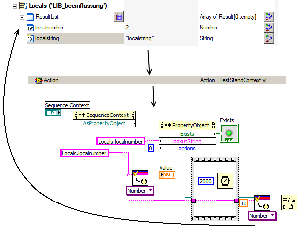

In runtime it works, but i want to set the value before when i develop the testsequence.
For example: There is a testseqauence with a Local.localnumber I want to set with a vi and change the values to 10.TeststandLocal.png
If I run the sequence, the value changes to 10 but after the sequnce is over it changes to the default value of 2. Is it possible to change the value durable?
