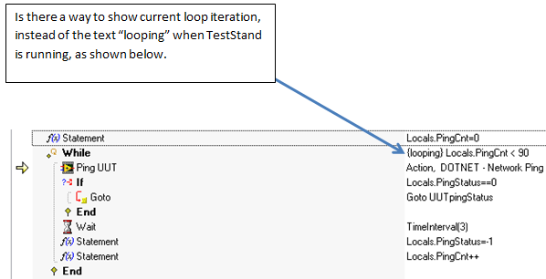

Hi Everyone,
Is there a way to show current loop iteration, instead of the text “looping” when TestStand is running, as shown on attached picture. Thanks,

Use a FOR loop instead.  And looking at your code, you should be using a FOR loop anyways.  It would cut down your number of steps.

Also, I am running main sequence in a loop (over 50 times).  Is there a way to display status of main sequence pass/fail results for each run, so I could count how many times pass/fails?
(5,576 Views)
I would just keep those in variables and you can watch the variables.

Another idea is that you can just place down a action step using the none adapter.  Change the Status expression to evaluate to a string.  For instance Str(Locals.PngCnt).
As the test executes you can see the Status column display the values.  This is especially nice to view variables without having to pause the execution.
