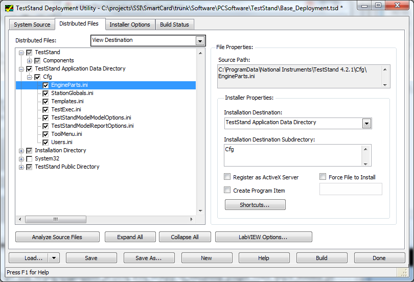

I've attempted to create a base installer - one that installs NI DAQmx 9.1.0, NI Serial 3.5.1, TS 4.2.1 w/the Simple CVI Test Executive. My new workspace has the StationGlobals, ToolsMenu.ini, Users.ini, etc. Those now properly show up in the Distributed Files tab as you mentioned. See the following screenshot. Also in the screenshot is the installation destination - TestStand Application Data Directory. These seems correct.

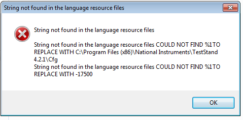

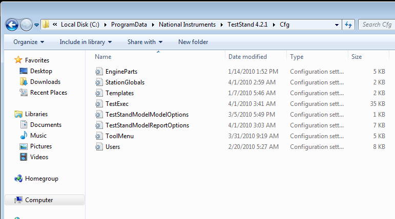

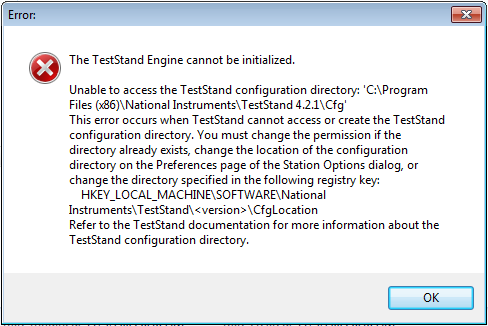

When I run my installer (which is a huge 1.33GB file... NI DAQ takes entirely too much space), when I attempt to run the testexec, I reports that the .ini files are not in the correct location which it thinks is the  C:\Program Files (x86)\National Instruments\TestStand 4.2.1\Cfg directory, which is incorrect. They are in the C:\ProgramData\National Instruments\TestStand 4.2.1\Cfg directory.
This problem looks like the installer attempted to follow the shortcut to get to the ProgramData directory which is not working here. Is the "TestStand Application Data Directory" the correct destination for these files?

The "TestStand Application Data Directory" is the correct location for the cfg directory, so I want to check some things on your end.  First, do you have a shortcut directory at C:\Program Files (x86)\National Instruments\TestStand 4.2.1 that goes to cfg?  If you do, does it point to the right folder (the one in ProgramData)?
Also, when you ran your installer, did you run it as an administrator, or at least get the Windows UAC prompt when you installed it?  Finally, when you run your TestExec.exe, do you run that as an administrator?  If not, does running as an administrator change the behavior, or do you still see the error?
