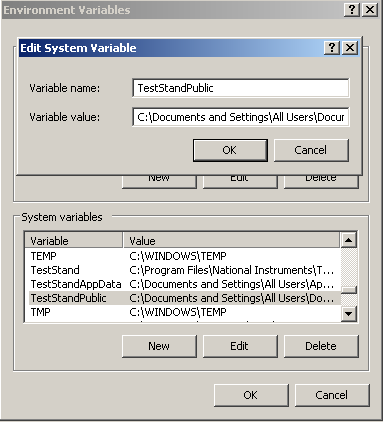

I would also try to change the TestStand Public Environment Variable.  This was introduced as part of the Vista compatibility, so you can simply change this variable to control where TestStand looks for those files.  It points to the C:\Documents and Settings\... directory by default, but if you change it to point to C:\profiles\... it may fix your issue.  If you look at the screenshot below, I would simply replace the 'Documents and Settings' part of the path with 'profiles' and that should point TestStand to the correct directory for your machine.
