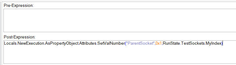

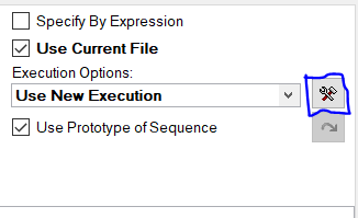

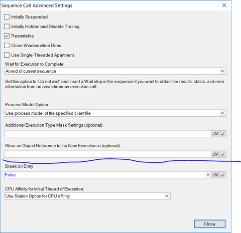

When you call a step in a new execution, you can store back an object reference to the new execution:
So, you first create a variable of type Object Reference to hold this reference. Then, in the post expression for the sequence call, you can attach a new attribute to the execution object that contains the caller's socket index. In order for this to work, you have to explicitly cast the new execution object to a Property Object.

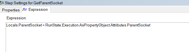

Then, just use an expression to fetch that attribute into a convenient variable inside the new execution (again, you need to explicitly cast to a property object here to leverage the attributes).
You can find a simple example that just reports out the parent socket in a message popup attached to this post.
