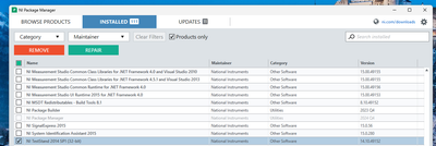

I tried to repair TestSTand, see picture below.

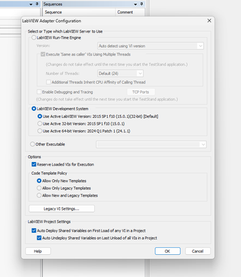

What do the LabVIEW Adapter Settings on your machine look like? Menu-> Configure-> Adapters-> LabVIEW
IMHO, you get this error because yur TestStand Version is quite old and as such it is NOT installed using NIPM.
You should be able to "repair" the installation using the Windows Control Panel ->  Software (or whatever it is called these days)
Yet I recommend to execute the steps mentioned above BEFORE repairing. Don't panic!

These are the adapter settings
Also Labview is working alone, and i can run VI's, open projects.

Ok, this is good news so far!
