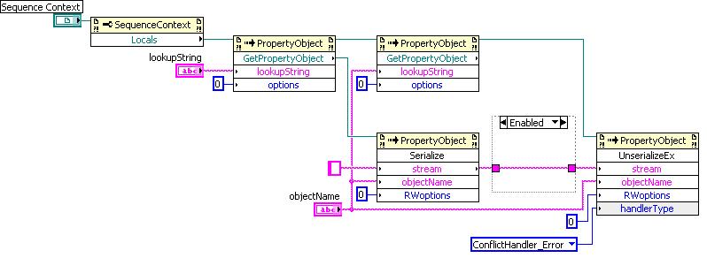

Hi all,
I'm having a few problems (mainly due to lack of understanding) with serializing and then unserializing a Local Variable.
I have two local variables, one called "start" and the other called "end". Both are identical types.
Using the below LabVIEW I am attempting to Serialize the variable "start" (contained within lookupString) and then Unserialize it into the variable "end" (contained within ObjectName). Although this seems utterly pointless, the final code will serialize any given variable and save it to file. I will then have a separate vi to read in the file and unserialize it into a given variable.
Any pointers/tips much appreciated.
Steve

Ok, I had some lunch took another look and found the problem.
My UnserializeEx invoke node is using the wrong reference Doh!
