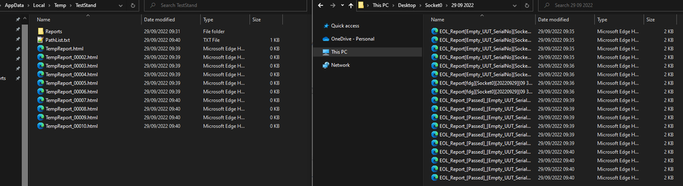

The "...\Local\Temp\TestStand"  folder is filling up with empty html or xml reports (ex. "TempReport_00002.html") -- and this is slowing down the production machine (20k+ files in couple of days). It's creating one empty file per UUT.

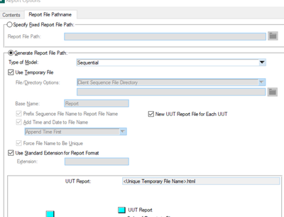

The only time i got this was when i enabled the Use Temporary file flag.
What version of TestStand are you using and can you share the report settings and procedure which leads to the temporary file creation.

Left - empty reports created --- right - actual reports created based on the ReportFilePath.
