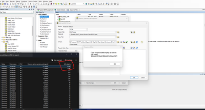

Teststand is getting crash after 10000 GID objects
My Test Stand getting crashed after it reaches to more than 9999 GDI objects
(779 Views)
This is typically an OS limitation and not the application. The below link to a StackOverflow post has discussion, links to Microsoft documentation, and suggests possible settings in the OS to mitigate the issue. Not sure how the OS and the settings impact 32- and 64-bit applications.

Thank you , I'll try this one.
