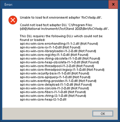

I have freshly installed Teststand 2020 on Win 10, but am getting this error.  DOes anyone know a fix?

Did you try running the version selector?

Heya,
Jiggawax is correct with the Version Selector as a first step.
Otherwise, can you please confirm:
  • The existence of C:\Program Files (x86)\National Instruments\TestStand 2020\Bin\flxCVIadp.dll
  • That you have user access to the AutoMgr server (C:\Program Files (x86)\National Instruments\TestStand 2020\Bin\TSAutoMgr.exe) if you go Properties->Security and verifying that you have the ability to execute this (Read&Execute)

Hi Barionics,
Where you able to resolve this issue? I am getting the exact same issue on my Teststand 2020 deployment system on Win10. Thanks!
