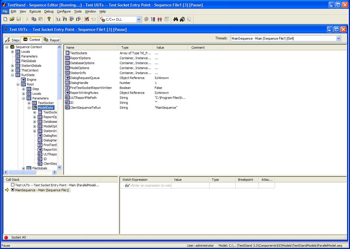

For the dialog handle, the knowlegebase article says:
use "RunState.Root.Parameters.ModelData.DialogHandle"
but I get the following error: 'unknown variable or property name'
could this have changed slightly in TS 4.0?

I think you can ignore this error.  The data/handle is not available untill runtime.  If you pause in your sequence and browse the context, the path is there.

yeah, under Root I just have (Object Reference) so I typed it in by hand, no problem. I just forgot about it not being there until the sequence was run. we did go over that in class, I just forgot.
thank you, guess I'll try running it.
