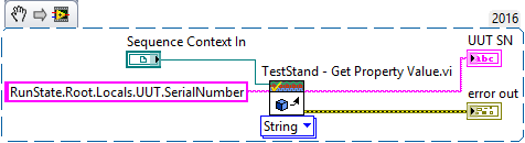

Hello guys,
Please, I'm trying (without sucess) to use the serial number from UUT field in test stand to VI labiew. I need to use the serial number into string field (extreme simple). But I don't know how to do this...Please I need help.

Try something like this:
You'll need to pass ThisContext into the VI when you call it from TestStand.
Hope this helps,

Nice!!
Works... please one more question. I'm using action in step types. Whats is the best to check this?
