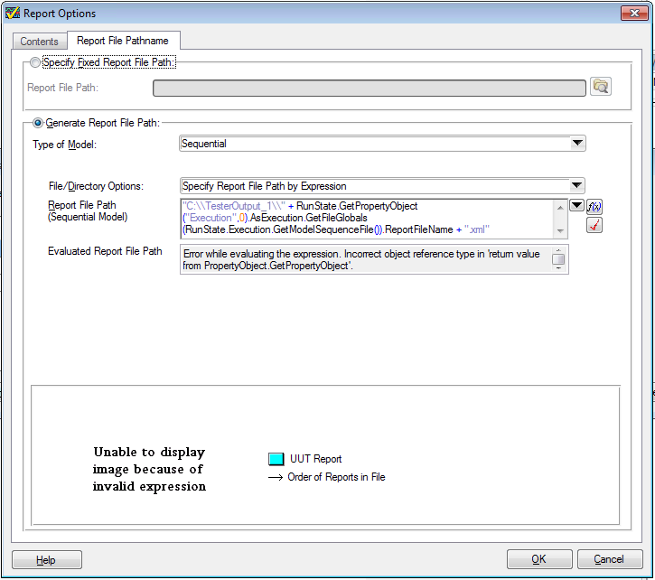

Please find enclosed a screenshot of the report config:

After going through the web all morning I've found it is possible to save the report by Specify Report File Path by Expression.. please see screen shot.. but my problem is the report path is generated BEFORE I get a change to pull in the serial number of the card...

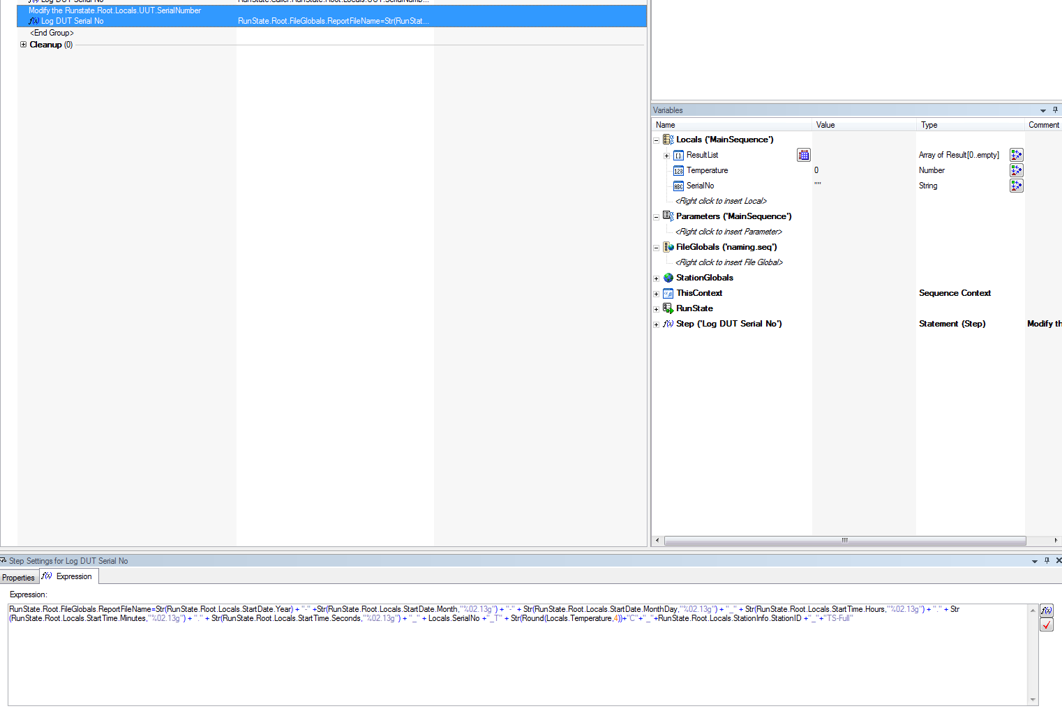

I'm getting the serial number of the UUT during the Startup section when the Teststand Seq is running and then modifying the Runstate.Root.Locals.UUT.SerialNumber variable with the actaul serial number (ie not scanning it in at the start of test).

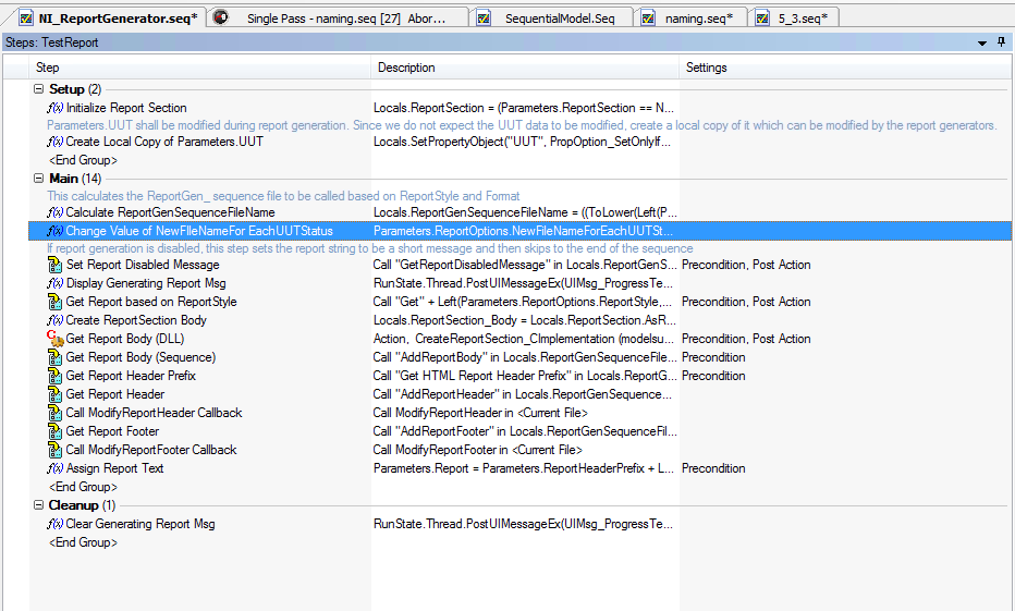

  2. In the Calculate Report Path sequence of the NI_ReportGenerator.seq plug-in, set Parameters.ReportOptions.NewFileNameForEachUUTStatus to true before the first if statement is evaluated.  This will override the UUTStatus macro check and force re-evaluation.

  1. I tried what you said in step 2, I set the parameter NewFileNameForEachUUTStatus to true before the if statement is evaluated. See here:Screen Shot 2015-02-25 at 5.27.47 PM.png

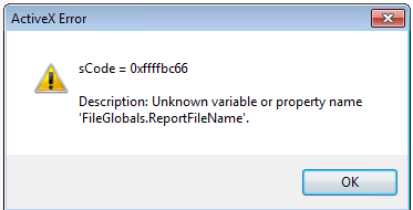

  3. I try to write to the new FileGlobal from my regular test sequence with an expression: FileGlobal.ReportFileName = Locals.SerialNo.  But when I do this I get an error that says

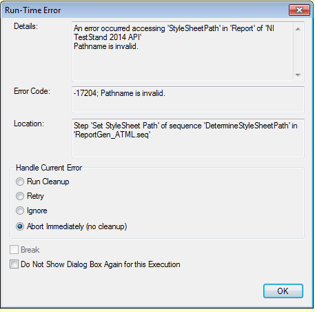

I hit ok and then I see the first run time error in the process model.

  1. Edit the Ni_RerportGenerator.seq plugin found in C:\Program Files (x86)\National Instruments\TestStand 2014\Components\Models\ModelPlugins\
    • You go into this file and add the step higlighted in Blue at that same location. Please see the expression I typed in the expression box. Setting Parameters.ReportOptions.NewFileNameForEachUUTStatus to true forces re-evaluation of the report name at the end of the sequentialmodel.seq.Screen Shot 2015-02-26 at 2.51.02 PM.png

  3. Then I added an expression in my test sequence that modified the the new FileGlobal I created:
Finally I updated the report options (Go to Cofigure>Report Options > Report File Pathname and under File/Directory Options select "Specify Report File Path by Expression" and I entered my expression. It appears that you can disregard the evaluated report file path error (box below) because your pathname won't be generated until run-time.
