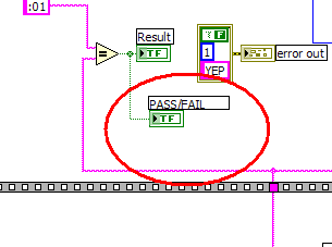

Hello, I have a quick question; i am using Labview 8.5 & Test Stand. I am develeoping Test Scripts using Labview for the design & using them in Teststand as PASS/FAIL tests. My question is when i run the tests in teststand its showing that the tests what i have written in labview has been passed but when i remove the connection to UUT & run the same its showing that tests are passed. Actually at this time it should show that the tests are failed since the connection to UUT is not present. But on the lab view window its showing the proper result(that the is failed due to to bad connection) but on the test stand window side its showing erroneous results i.e. tests are passed(i.e. the result is not being updated from lab view to test stand window). What should I  do  to update the result from lab veiw to testand . I have this problem from couple of days.

Adding to the previous reply, even if i make it false & if i still connect to UUT, i am getting the correct result (Right value since UUT is connected) in labview but showing the result as failed(since step.result was set as false), in this case since i am getting correct value on labview , that means that the test is passed .
And suppose if i connect UUT & set step.result as true and suppose that if their is a  problem with my UUT that i am testing , i should get the halt in the PASS/FAIL test, the result on the labview says the result is erroneous but the same data is not being passed to test stand so its showing that the test has been passed which is wrong.

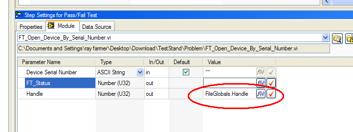

Hi basha,
Looking at your Sequence File and the Pass / Fail Step in MainSequence.
Although you have three connections on your VI FT_Open_Device_By_Sreial_Number.vi (one input, two outputs),
within your step, you haven't connected them to any TestStand variables.
I have attached the FileGlobals.Handle to the Handle output of your VI as an example.
You need to do something similar for Device Serial Number and FT_Status.
I am not sure where this top level vi comes in, are you hoping to replace FT_Open_Device_By_Sreial_Number.vi with this top level vi.
If you are then you need to connect on input and output to its connector pane. I would suggest the boolean result is one of the ouptut
Which you connect to Step.Result.Pass/Fail

Basically in this file i am checking for the FT_Status Output. I have connected it to the teststand the way you mentioned & left other things to the defualt value.
Now when i run the test stand window, i am getting hte FT_Staus value 1 on the labview window, but the result  "1" is not updated on the test stand side . I dont have a clue
why its happening like this.
