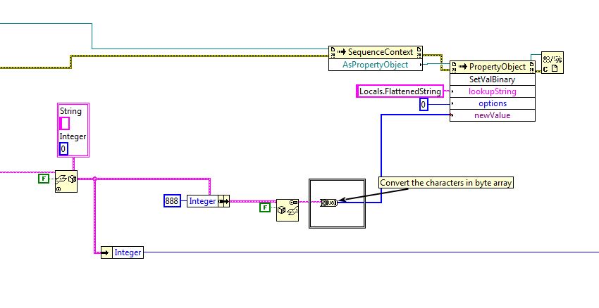

Ciao Amitai,
you did almost everything correctly, 99% is ok, you just missed one part.
In order to behave correctly the SetValBinary wants binary data, so when dealing with strings you need to convert them in byte arrays.
I've just added that function and now it works just fine:
Attached you find my modifications. I've used TS 2014 and created a version of the sequence for 2013 called 1_TS2013,.seq

Shalom Andrea,
Thanks a lot for your reply,
In fact, I’ve found a resource that explains that binary strings may contain null characters, so I have used this conversion but tried to write it to a INT array in Teststand…..
Your idea makes much more sense.
