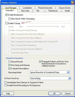

The test you have done is very interresting. Now it's important to determine if the issue is on the execustion of the differents TestStand step or in LabVIEW.
For this can you said me if you have disable the step tracing on the station option :
22409iF62233679BCFB35B
Can you post a simple project (sequence and VI), with the entire project I can try to reproduce the issue.

Cristophe, on Station Options I have enable tracing TRUE, and the speed set to FAST.

So could you test to disable tracing option.
