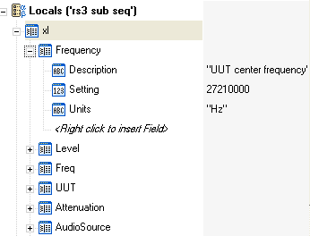

Hi John (strobist),
We also pondered this issue for a while and in the end we decided to read in the data from Excel and dynamically (programmatically) create the parameters and store them in a container. Each parameter from the file is also a container which has three variables to represent the parts (as Frequency shows below).
So - these parameters are read in and created every time the sequence is run - twice. Once for the runtime context, and once so that they remain after the run is over. That way it is easy for the developer to use the variables when creating TestStand steps.
In the image below, the container 'xl' was created at runtime by reading from file.
As the programmer you can choose the order in which to create the objects.
You've probably done it already, but if you search for programmatically create variables / parameters etc. you'll come up with a whole slew of info.
