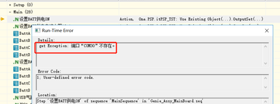

Here is the C# code which is to copy to Runtime Error Msg to C# UI(richTextBox1) when error happen:
case UIMessageCodes.UIMsg_RuntimeError:
  Execution exc = axExecutionViewMgr.Execution;
  PropertyObject po = exc.AsPropertyObject();
  string LookupStr = "RunState.Step.Result.Error.Msg";
  string ErrorMsg = po.GetValString(LookupStr,PropertyOptions.PropOption_InsertIfMissing);
  richTextBox1.AppendText(ErrorMsg + "\r\n"); //Can run Here but Why alway get empty ErrorMsg?
break;
My question is why it can not work, Please give some advise,thanks a lot.
Attach the TestStand MessageBox screen shot:
(2,958 Views)

Maybe my question is not described quite clear. Actually I was confused  that when runtime error happen, and teststand already showed the error message, how I can obtain the message again by C# code. So I tried by above ways(GetValString) and get the empty error message(Not the expect error message just showed as the sceen short: Com Port is not exist). Is there any problems of my way of using GetValString ? Or can you tell me which is the right object to choose (you mean the LookupStr of "RunState.Step.Result.Error.Msg" is wrong?)
