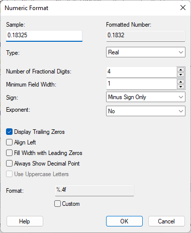

In my TestStand 2019 application the number 0.18325, with 4 decimal digits (format string %.4f), is rounded to 0.1832. I would expect 0.1833,
as indeed happens correctly for 0.18326, ... , 0.18329, since the fifth decimal digit is greater than or equal to 5. Am I missing something? These are my custom number format settings.

A format of %.4f is a purely cosmetic property. Assuming the underlying numeric is in DBL representation, the closest number to 0.18325 that can be represented correctly in binary is 0.183249999999999996 and thus will be rounded to 0.1832 in any typical rounding scheme.
