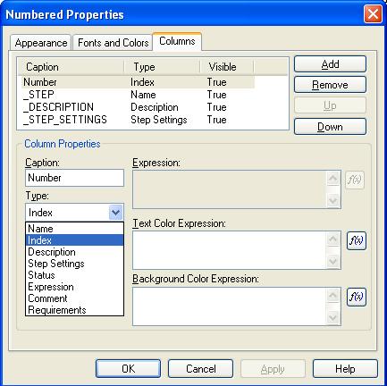

Krishna,
If you just want to know the index of a step, this information is displayed at the bottom of the sequence editor in the status bar.  It shows you how many steps there are in the sequence, how many you have selected, and the index(es) of the selected step(s).
It is also possible to display this information in the steps view as a column if you are willing to create a new column.  Follow the instructions in this KB to see how to create a new column:Changing Columns Properties of the TestStand Sequence Editor Execution View Window.
One of the types of colums is Index. Simply set your column to that type and you will see step indexes as shown below.
Message Edited by Josh W. on 07-01-2009 01:50 PM

Thanks josh.
Krishna.
