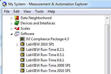

Can you check in the Measurement & Automation Explorer and see what versions of the LabVIEW Run-Time Engine (RTE) it shows that you have installed?

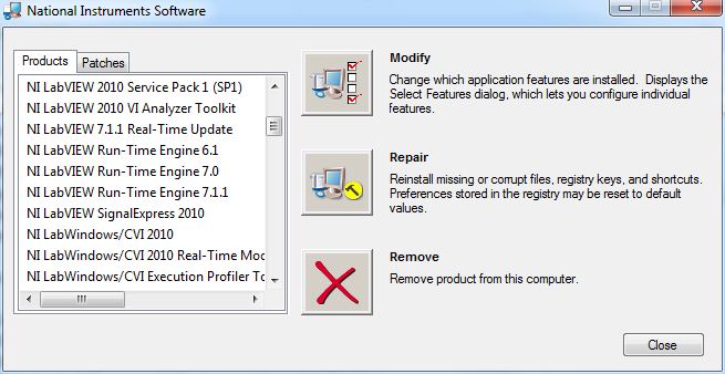

Also, can you check in the Control Panel, Add/Remove Programs, National Instruments Software and see what versions of the LabVIEW RTE are shown?
If it doesn't show that either LabVIEW RTE 7.1 or 7.1.1 is installed, you should be able to get the 7.1.1 RTE by installing the NI-FGEN driver.  The LabVIEW 7.1.1 RTE installs with the NI-FGEN driver and it doesn't check for newer versions of the RTE, but it is a large download so it isn't the greatest workaround.  If you'd like to try it, it can be found at NI-FGEN 2.8.
