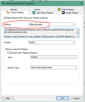

Take a look at the C/C++ Struct passing example:
C:\Users\Public\Documents\National Instruments\TestStand 2019 (32-bit)\Examples\Fundamentals\Passing Structs to Code Modules\C
You create TestStand types that match the struct and set the properties to align with the data; and note that there are different packing options depending on how the DLL was built.
"The development environment that you use to create DLLs determines the options for the structure packing value.
Visual C++ and Symantec C++ use a default of 8-byte packing. LabVIEW, Borland C++, and Watcom C++ use a default of 1-byte packing. For LabWindows/CVI, the default packing can be 8-byte or 1-byte, depending on the compatibility mode. For example, in Visual C++ compatibility mode, LabWindows/CVI uses a default of 8-byte packing."
