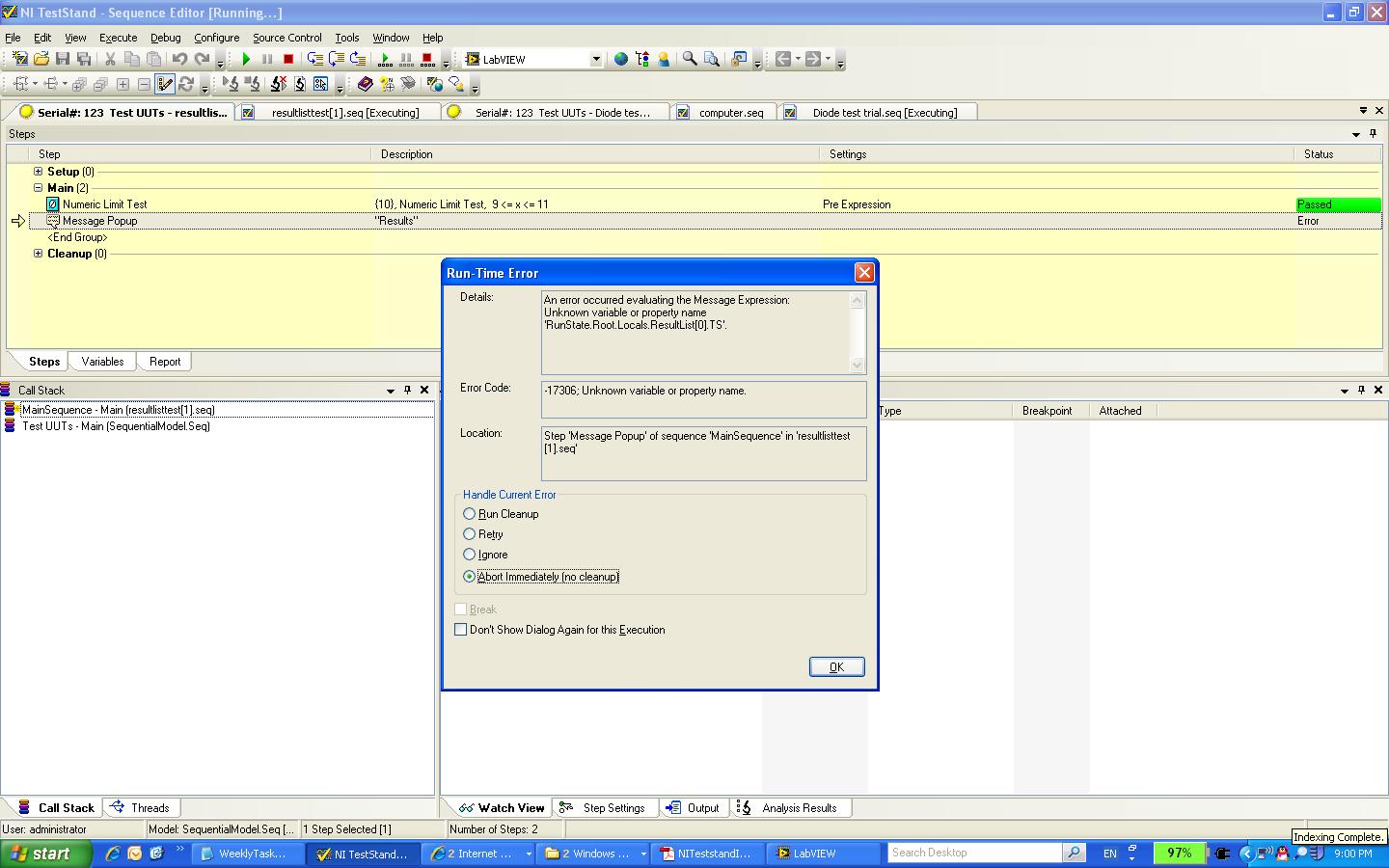

Why did i get an error when I ran your example?
Message 8 of 10
(7,687 Views)
My guess is you are seeing that error because of an Unknown variabe or property name.  🙂
I don't know what the author of that sequence file was thinking.  The process model Locals.ResultList won't be populated until MainSequence returns.
jigg
CTA, CLA
testeract.com
~Will work for kudos and/or BBQ~
Message 9 of 10
(7,678 Views)
Hi Jane.Yu and jiggawax,
If you run the example I posted a while back without a Process Model (i.e. just Run MainSequence from the Execute menu), the property will exist.  However, a better place to get this information from would be simply Locals.ResultList[i], where i is the index of the result you are looking for.  In other words, you can simply remove the RunState.Root. from the MessagePopup step's expression.  This property will exist unless you have both On-The-Fly Reporting enabled in the Report Options and Discard Results or Disable Results When Not Required by Model option selected in the Model Options.
Sorry for the confusion in the example.  I hope this helps!  Have a great day!
