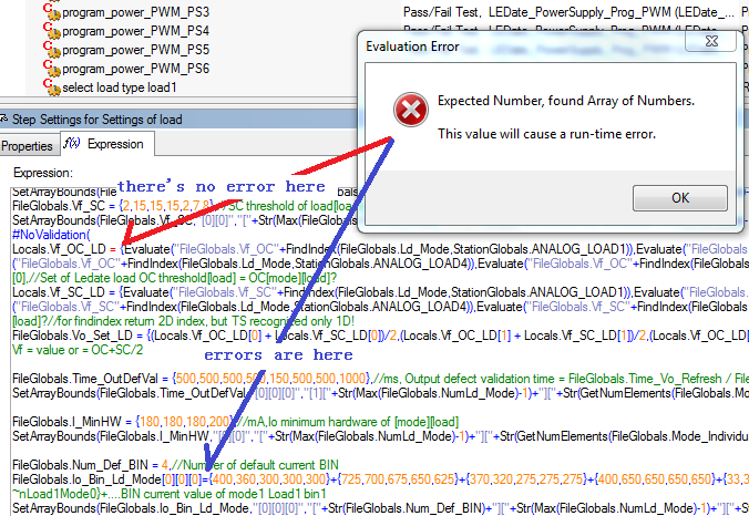

I add a #NoValidation in my expression to aviod error pop up unexpected. but each time when i have errors out of #NoValidation(), the error locate to this function wherever the error is, please check below picture for your information.
it's hard for me to check errors out when the expression gets too long.
