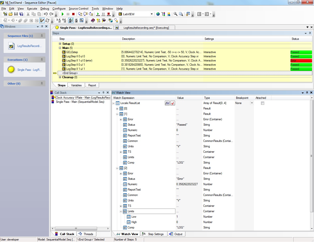

screen shot:

I am not seeing this either (error or no error, with No Comparison the Limits are empty), is this soemthing to do with your Log Step Type or is it just a code module?
