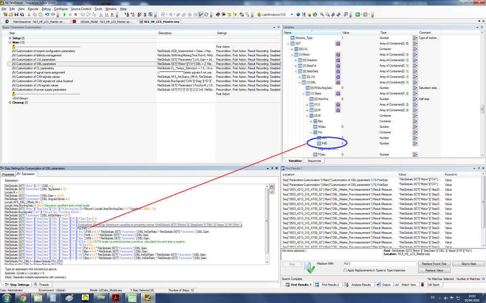

i'm using TS2016 and when i copy a number variable in an container to expression, it show "unknown variable or property name" warning but obviously the variable is just locate there.

In your array called 'Steps', you have 2 array elements which are called 'M'. So in your expression, I guess you want to use the second 'M' element which have a "Pol' subproperty.
But I think TestStand use the first one and I suppose that this one don't have any 'Pol' subproperty
Laurent
(3,253 Views)
Thanks, it's duplicated, issue removed after 1st M deleted
