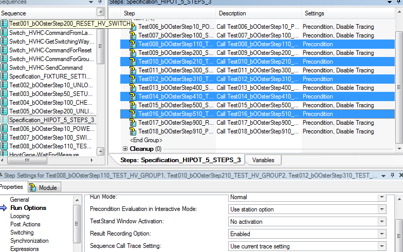

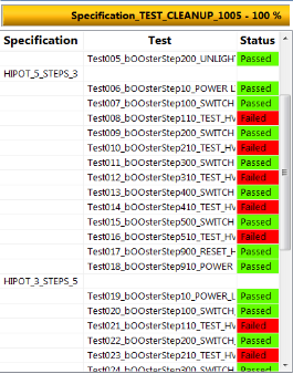

We used the HMI built by labview,You can see all the HV test are failed.Normally I didn't simulate any error on product and expect all passed
Then I tried to open the dynamic sequence for debug,And set all the subsequences of "H
IPOT_5_STEPS_3" (sequence call trace settting as "use current trace setting".
Execute the sequence with Teststand,Will get the sequence(HIPOT_5_STEPS_3 is passed)
