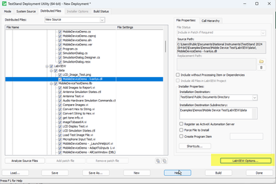

The TestStand Deployment utility lets you put your .vi CodeModules into a PPL. You have to make settings using the LabVIEW Options (https://www.ni.com/docs/de-DE/bundle/teststand-api-reference/page/tsref/labview-vi-options-dialog-bo...
So this is an actual build process!
