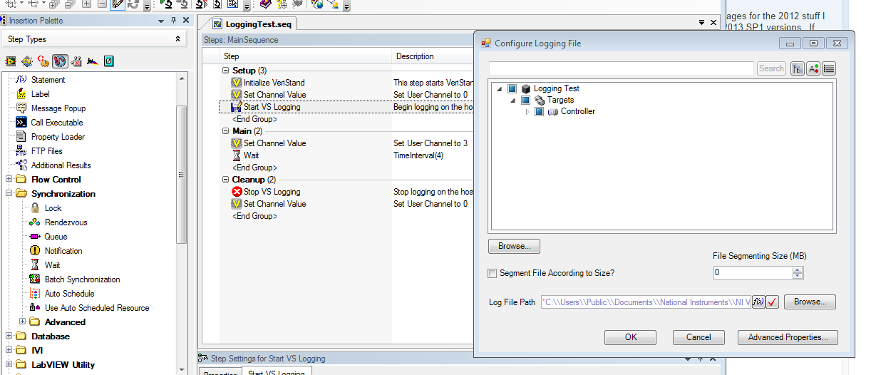

I downloaded _v310 and I'm testing out the Start_VS_Logging step for the first time.
Here is a capture of the step's configuration:
Here is the error I get when I run the sequence:
Any ideas?  I've tried different paths so I don't think that is the issue.
Thanks.
Message 176 of 202
(1,499 Views)
I didn't actually implement that one but paths would be my guess. That is the path for logging on the gateway machine and you need to have write access to it.

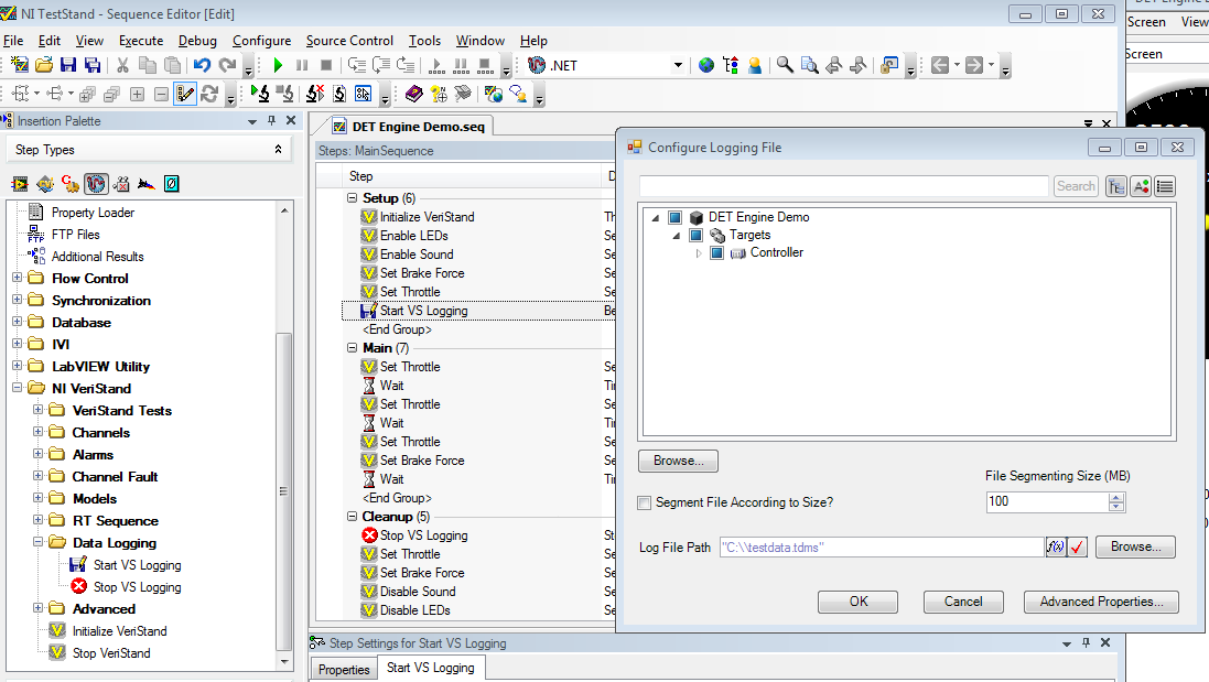

Holt,
I developed that step.  I'm pretty sure you started a log and then did something to abort the sequence.  When you did that, you left the log running.  It'll keep running until the system undeploys or until you execute a Stop Logging step.
One easy way to do this, once it has been done, is to make a new sequence and drop just a Stop Logging step into it.
A better way is to keep the Stop Logging step in your Cleanup section, and never Abort unless you absolutely have to - Terminate instead so the Cleanup section runs, stopping your log.
What I am trying to do in the next couple of days is to add the logic to stop and restart the log in this case, recovering gracefully and running as expected, while giving the user a warning in the report.  I hesitated in doing this, because it gets a little easy to abuse the system that way.  I  don't want users accidentally running logs when they think their sequence file is stopped.  Do you have any thoughts on this?
Message 179 of 202
(1,499 Views)
HandyAndy,
I created a new VS project and just added a single user channel to simplify the test.  I'm also deploying it to Windows.  I placed the Stop logging step in the cleanup and I get the same error.
Message 180 of 202
