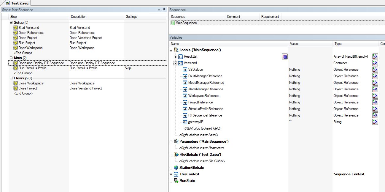

OK, these are from my lab workstation, the one that's running all the 2012 versions.
Here'e the TS sequence, as you can see, it's dirt simple:

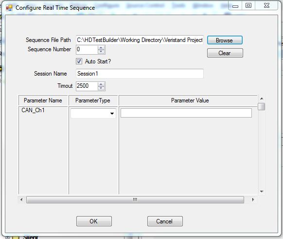

Here the config dialog from Open & Deploy RT Sequence after I've selected the sequence:
Note that none of the steps are populated. If I start populating them manually, weird things start happening, like slow, stuttering auto-scrolling, graphical glitching in the dialog (looks like all the steps are accordioning together), etc.

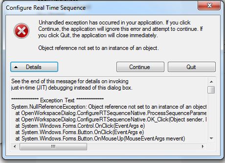

Here's the error dialog I get if I click the OK button:
I can post the entire text of the exception error, but it's rather lengthy.
