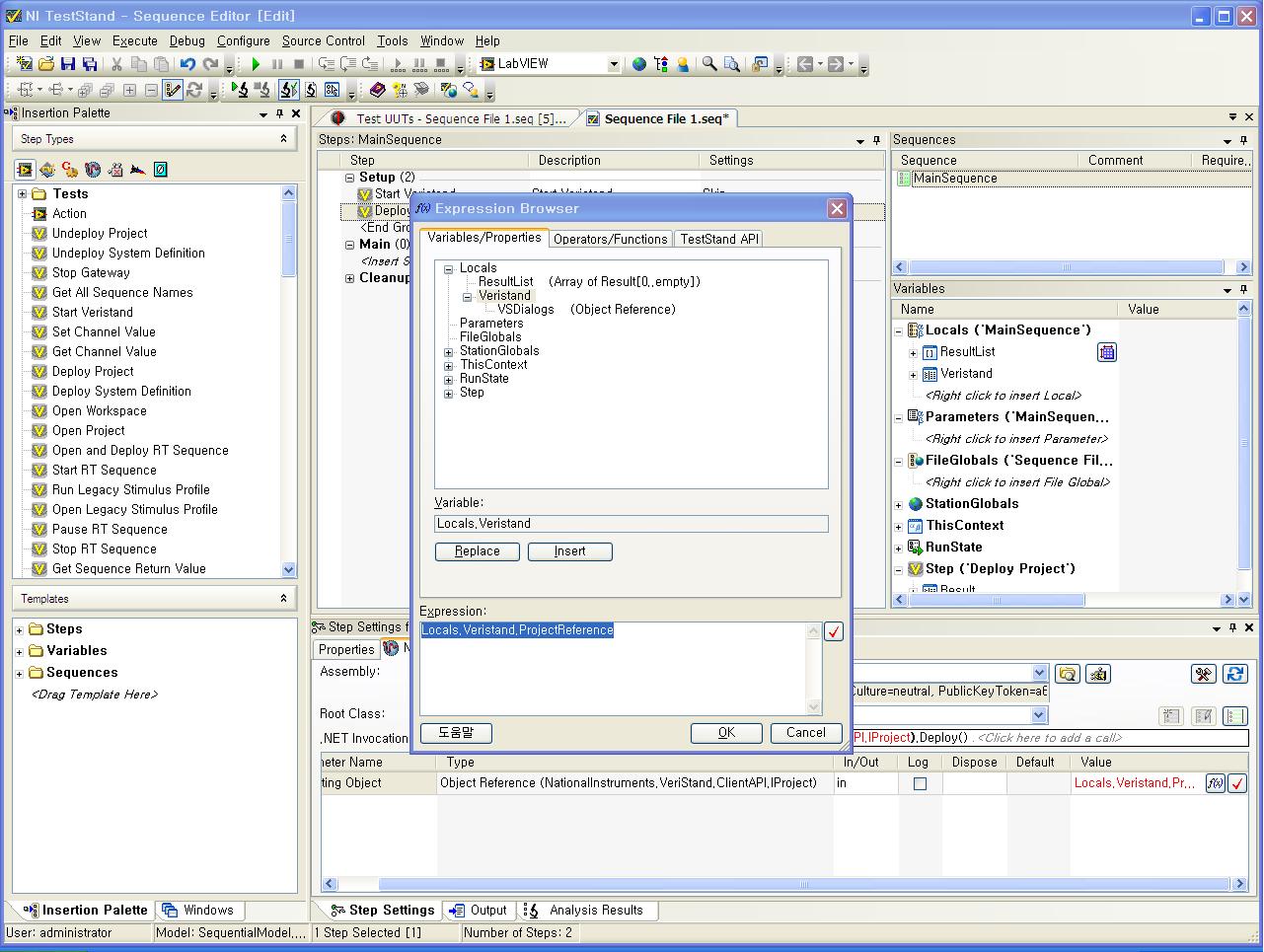

there is no expression in browser. how could i add expression ?
Message 22 of 202
(8,111 Views)
Hey,
I am not sure I understand what you mean by there being no expression browser.  Can you clarify what you are trying to accomplish?

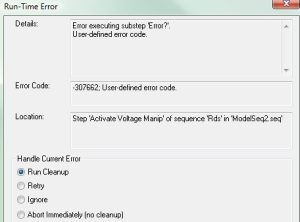

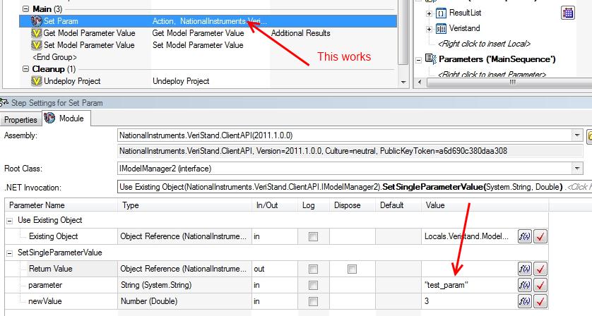

Hello Kevin,
i have tried to set a model manager parameter with an underscore inside
and it did not worked and i get the following error -307662.
Picture2.jpg.
When i do the same with an action .NET step everything works.
If you need more information please let me know.
best regards
Alexander
Message 24 of 202
(8,111 Views)
Woops, I didn't account for _ correctly in my regular expressions.  I will add a fixed installer later today.

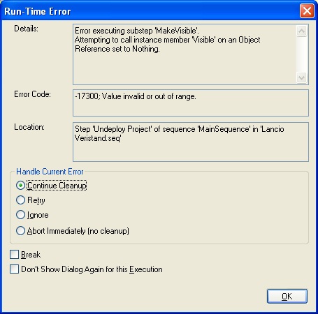

Hy Kevin
Thank's for better work, custom step veristand
I've this problem don't run a project veristand to use a step project, appare a error -307652 SetBoolean.
Have you PLEASE one solution?,
I have a virtual machine with winXP, TestStand 2012 f1 (5.0.0.262) and Veristand 2011 sp1 (2011.1.0.32)
Message 28 of 202
(8,111 Views)
Hey vaccaro.d,
You need to have VeriStand open (or use the Start Veristand Step) before running a sequence.
Let me know if that doesn't fix the issue.
Kevin
Kevin Fort
Principal Software Engineer
NI
Message 29 of 202
(8,111 Views)
Hy
Success but i have insert a wait of 30 sec before Open Project step.
else appare popup error
Thank's for this
I had to correct in the custom step type VeriStand this DataType:
Undeploy Project lacked the container VeriStand reference
also in the post step edit was wrong with the link Locals.Veristand. RTSequenceRefence that I restored with Step.Veristand. RTSequenceRefence.
Same for Open and DeplotRT

1: how do I pass values ​​to the workspace and enable a boolean, I have try with stimulus but are not passed
2: why have I error the Undeployed Project step
Best Regard
Davide
