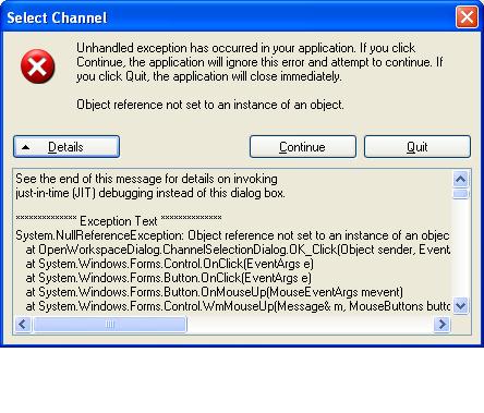

I had try to use the Set Channel Value Step but I am very unluck or....
Crash the Teststand for this error
SetChannelError.JPGI send you two file by email. Thank's you
Message 32 of 202
(7,823 Views)
Hey Davide,
If you send these to me or post them here I can take a look at what is going on.

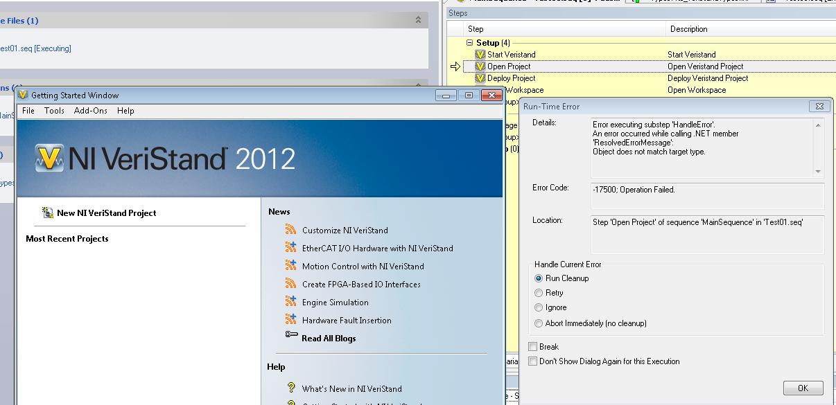

Hi Kevin,
I am using Veristand 2012, Teststand 2012 and LabVIEW 2012. I have got the same error Vaccaro. Then I realize that i need to start Veristand 2012, not Veristand 2011 as also installed to my maschine.
How to modify step "Start Veristand" to call Veristand 2012?
Thank for your help!
Rajamodol
Message 34 of 202
(7,823 Views)
Hey Rajamodol,
To modify the steps for 2012 other than start Veristand you just need to change which version of the assembly they are calling. For start VeriStand its a little trickier since the assembly call we used to make that step in 2011 doesn't exist in 2012 anymore.
I am currently working on a 2.0 release of the steps which will support VeriStand 2012 as well as add a couple of new features.
Kevin Fort
Principal Software Engineer
NI
Message 35 of 202
(7,823 Views)
Hi Kevin,
Thanks for your quick reply.
I was looking in Veristand .NET API just to change "NationalInstruments.Veristand.VeristandSteps(1.0.0.1)" to version 2012. I didn't find any..:(
I modified then the other steps like Open Project, Deploy Project, and OpenWorksspace to NationalInstruments.Veristand.ClientAPI(2012.0.0) without modifying any other variable.
I run first Veristand 2012 manually, and then run my sequences. Then i received this error.
If you don't mind, are there any variable i shall modify?
Rajamodol
Message 36 of 202
(7,823 Views)
Hey Rajamodol,
The issue you are running into there is that the post steps which handle the VeriStand errors are also set up for 2011, they need to be updated to point to the 2012 API.
Kevin Fort
NI
Message 37 of 202
(7,823 Views)
