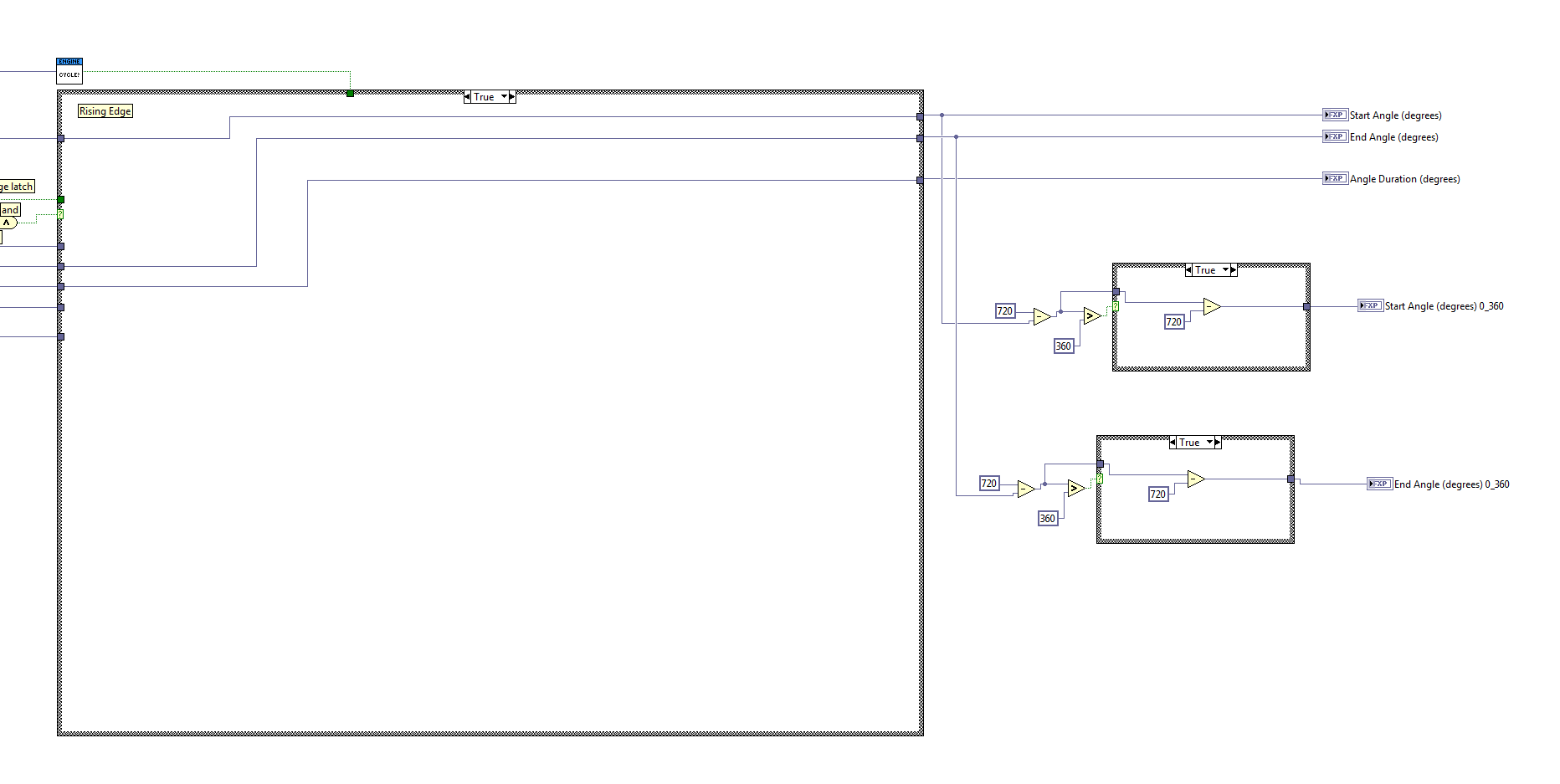

Next problem: My ECU actuator (fuel injector) readings are +/- 360 degrees before TDC. (NI veristand is 0-720 after TDC)
So i want to scale the "start angle" and "end angle" variables in the fuel injector VI. The equation is simple;
720 degrees - the original NI start angle.
If that value is > 360 then take away 720 from it.
I've did that in the VI.
I tapped off a line from the original angle values and performed the equation.
I added two new variables to store the result and re-assigned the existing terminals to referece my 2 new variables.
Problem: I seem to still get the old angles.
Can you see anything I've did wrong?
Perhaps i should tap off the original values outside the case statement and then scale them?
I wasnt able to connect one of my new locals to my new scaled value as NI gave an error. ( i was trying to match the original code method which is still fully intact in the VI)
James

Hi Stephen,
Attempt 2 :
I tried to run a wire off the original NI Veristand Start and end angles ( This time outside the case statement ).
The good news is that the first part of my scaling works ( 720 - NI veristand original value )
The problem is that when my case statement check for > 360 goes true i should take 720 degrees aways from the value.
instead of -360 i am seeing 664.1 degrees. 361-720 should = -360 approx.
Is this because of the type of the variable in labview??

Hey Jamesy,
I'm glad you were able to sync with the ECU. I'm curious why you still have 2 degrees of error. Did my commentary from before make sense? It should show there is no error from the simulator side.
The problem you're seeing is the FXP data types for start angle and end angle are expected to be unsigned, as the original outputs are. So those values cannot go negative. When using + and - nodes, you can right click them and configure what the resultant data type is... but the default after doing subtraction will be signed. So your math has changed the FXP data types from their previously unsigned state to now be signed.
So the value in the FPGA is correct then. you're not doing anything wrong in the FPGA... but the custom device is reading that value as a U64 and then translating it back to the originally expected data type of unsigned. Therefore the value the custom device sees is different than what the FPGA actually has.
The custom device code to read the values (as U64s) and change them to FXP data type is inside "\Engine Simulation\Source\Real-Time\Utility\FPGA Output Read.vi":
See there where it reads crank angle, start angle, and end angle... it reads the u64 and then uses integer to FXP cast with a FXP data type of +,61,10. But your modifications to the FPGA code has changed that data type. SO you will need to change the FXP cast data type in this custom device VI to match. Note this VI's case structure is for crank angle, start angle, and end angle... you will want to split this into two cases (one for crank which is unmodified, one for start/end which is modified) because you haven't changed the crank angle data type. When you're done, rebuild the custom device engine.

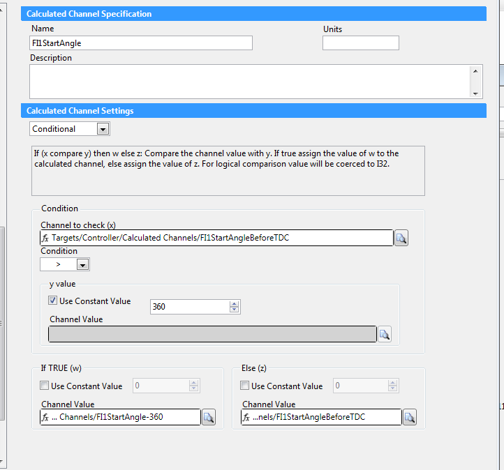

I think i can use a calculated channel. I'm going to try this out.
Question: Once the angles find their way into veristand, are they signed values? ie  can i then go less than  0 ? so 360-720 will == -360 ??

Yes they are doubles at that point. Calculated channels should work

My method has 3 calculated channels per event . thats 192 additional calculated channels in my system.
Any limitations of doing this? ( apart from being a lot of manual work)
Am i now removing the angle processing from my FPGA ?
So when i log angles v time will I'll see some perfomance issues?
James
Message 157 of 247
(1,061 Views)
Yeah... I'm sorry to hear that. Calculated channels are pretty cumbersome to use. And yes, this will have some performance impact. As long as you have them executed in the correct order... I think you will have a 1 cycle delay from when the custom device value updates to when the calculated channel value updates. It might be 2 cycle. I dont remember. You could log it and see.
You are still doing the angle detection in the FPGA. you're just transforming the value some when it comes into CPU.
