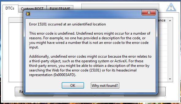

YES, deploy successfully. when i click the button referesh address after running project and popuping workspace, the error above will occur.
Message 91 of 175
(7,684 Views)
Did you try right clicking on the workspace and reselecting the custom device from the pop up menu?  That is what the error is saying to do.  I should make that more clear.

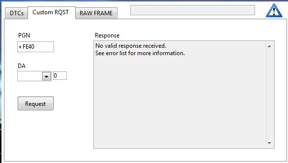

    I am Wangwen of Hirain,the customer of jarm.woo's. I tried to use 2 NI CAN channels to simulate the J1939 communication. One is as the sender,and another one is as the receiver. The result is same as yours, working successfully. But when I use the Third party tools(Vector CANoe, or customer's ECU), It fails, as jarm.woo descript. I have made many attempts, but no help. Could you please give me some advice. Thanks!
Message 95 of 175
(7,684 Views)
Hey Wangwen,
I am glad you got part of it to work!  What I would try next is to log my messages that do work and log the messages that don't work.  Then, compare them to see what is different.  Post the results here and I will help you as best I can.  I understand why the third party tool doesn't work as it wasn't supporting address claiming.  The customer ECU should work since it should support address claiming.  The only thing I have seen that would cause that not to work is how the ECU expects the fill bytes.  Some J1939 messages are not 8 bytes (like the requests for address claiming), so you either send the message as the actual bytes (ie. 3 bytes) or you send it with fill bytes (ie. 3 bytes of data and 5 bytes of xFF or x00).  Some ECUs care a lot about this and won't listen to you if you have the wrong fill bytes.  I think a log comparison of the two different transmitions is the place to start.

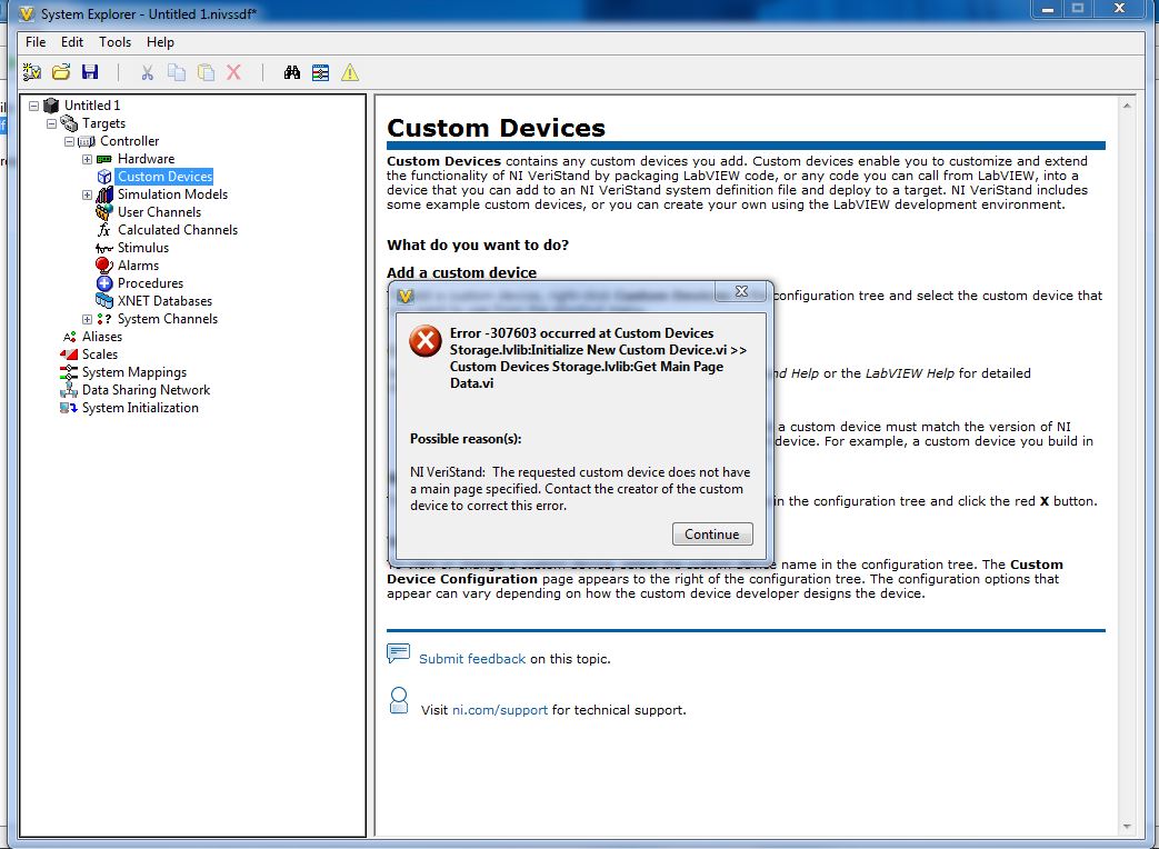

Thank you for your replay I am try to add workspace control to veristand but it show error please see below picture and according to the start up document I am trying to add J1939 addon to system defination that time it happens to me(Custom device).
Message 99 of 175
(7,684 Views)
Hey,
I just tried it on my system and I don't get any errors.  Please walk me through exactly what you did from the very beginning.  What version of the add-on did you download?  Did you get the built or the source?  Where did you put the add-on on disk?  Have you tried to change any of the code?  How did you add the add-on to the system definition?  Do you have a valid DBC file?
