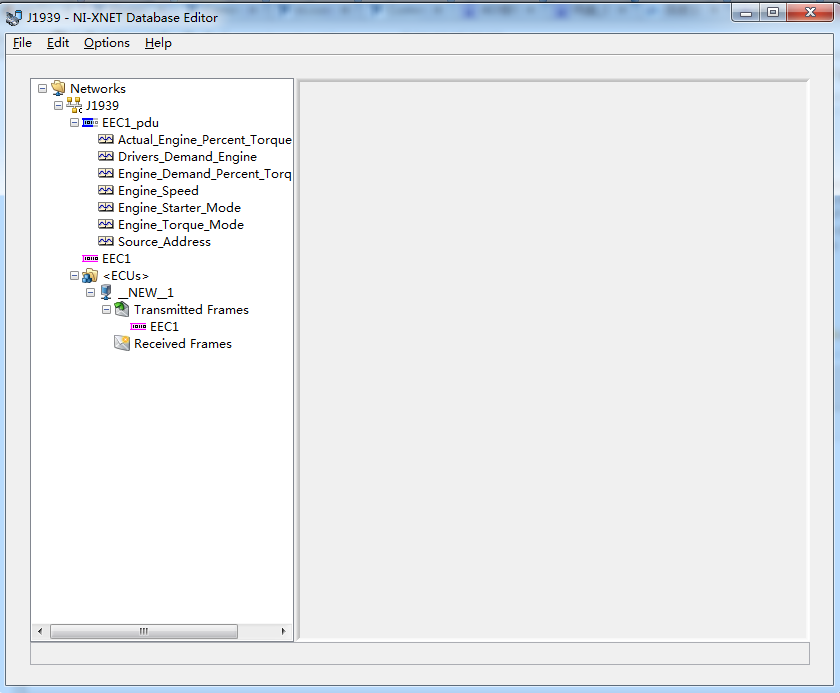

I want to use J1939 on labview-RT. I have 8513,XNET1.7. I don't know how to defination the j1939 database.
is that right for J1939?
I have use it send messages with J1939 add-on in RT system through veristand. But the kvaser receive error frame.
And I want to know what's the different between CAN and J1939.
Thank you!
Message 16 of 175
(7,893 Views)
That database doesn't look right.  Again, NI doesn't support doing messages over 8 bytes.  If you need messages over 8 bytes, you have to use a different database editor.  The message you are defining is only 8 bytes.  Therefore, it should work.  J1939 is a protocol over CAN.  You can think of it as CAN plus some extra functionaility that happens over CAN.  If you don't need the extra functionaility (namely, messages over 8 bytes or DTCs,) you shouldn't use this custom device.  You should use the built in CAN device (Targets >> Controller >> Hardware >> Chassis >> NI-XNET >> CAN).  Attached below is an example with a correctly created database for your message.  Notice that the database is used in the J1939 custom device as well as the normal CAN device.  Again, because the message is not more than 8 bytes, it will work in both places.  I tested it with my RT system and a 8513 and it works for me.  If you need to understand CAN or the CAN device in VeriStand or the CAN database editor, please contact your local support team.  If you have more questions on J1939, please continue to post.
