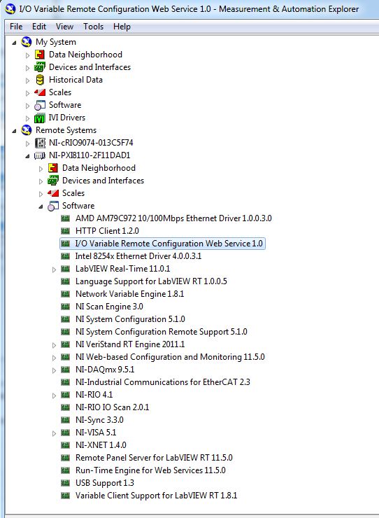

Did you install the remote detection web service to the target with MAX? It is one of the install steps. If that is not explicitly installed (it is unselected by default), auto detect wont work
Stephen B
Message 65 of 676
(6,430 Views)
Yes it should be installed.
/Martin
Message 66 of 676
(6,430 Views)

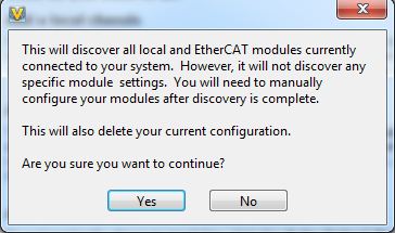

Well i get the following dialog after pressing Auto detect Modules
After pressing "Yes" nothing happens
/Martin

The 537700 indicates that the custom device did not detect an EtherCAT Master which matches with your system definition (iw. Master 0 was not found).
Two things to try:
1) Under the 9144 slave in the custom device, go to the "User Variables" section and click the "Revert Slave to Scan Mode" button at the top.  It's possible that your 9144 has a custom bitfile deployed to it... In your LabVIEW screenshot the modules are underneath the FPGA of the 9144, not directly under the slave itself.  Did you manually add the modules there, or did LabVIEW autmoatically detect them there?  There is a known issue where the API I use does not find the master or slave if there are no modules in the 9144.  I haven't tested, but this may also be teh case if all of the modules are currently reserved by the FPGA of the 9144.
2) FTP into your PXI controller and delete the contents of the c:\ni-rt\config directory, then reboot the controller.  You should make a backup of the files in this directory first, in case you wish to restore them.  The dynamic variable API can behave unexpectedly if there are variables deployed from LabVIEW, shich can be stored as config files.  Deleting these files can put your system back into a clean state, which should hopefully allow you to deploy and detect the modules successfuly.
