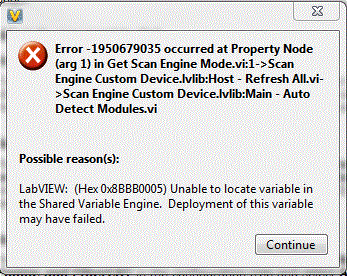

I am trying to run a Veristand project in a cRIO-9081 butI can't get the scan engine to work. I press the auto-detect modules and I get the following error.
Also, if I deploy the project I get the following error
The VeriStand Gateway encountered an error while deploying the System Definition file.
Details:
Error -1950678964 occurred at Project Window.lvlib:Project Window.vi >> Project Window.lvlib:Command Loop.vi >> NI_VS Workspace ExecutionAPI.lvlib:NI VeriStand - Connect to System.vi
Possible reason(s):
LabVIEW:  Failed to load NI Scan Engine software required for I/O Variable access.  If you are hosting I/O variables on an RT target, ensure that the NI Scan Engine is installed on the RT target. If you are hosting I/O variables on Windows, you must install a Windows I/O driver, such as DeviceNet, that includes NI Scan Engine support. If you are hosting I/O variables in a Windows VI, the VI must be part of an open LabVIEW project. If you are hosting I/O variables in a Windows built application, the application must be configured to include hardware configuration.
NI VeriStand:  NI VeriStand Engine.lvlib:VeriStand Engine.vi >> NI VeriStand Engine.lvlib:VeriStand Engine State Machine.vi >> NI VeriStand Engine.lvlib:Initialize Inline Custom Devices.vi >> Custom Devices Storage.lvlib:Initialize Device (HW Interface).vi
Any suggestions on how to get around this problems/errors?

Hi DeuxLatis,
Have you followed all the steps to install software as listed in the readme? It appears your target does not have the scan engine installed.
Consult the readme that comes with the download and make sure you haven't missed anything.
If you still have issues after that please post a report from your remote system. You can create this report by right clicking the target in measurement and automation explorer.
--Stephen Barrett (mobile)
Stephen B

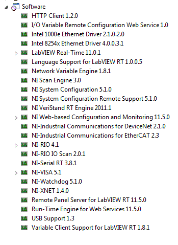

Hi StephenB,
I followed the instructions in the read me file and the scan engine is installed. Below is an image of the software installed in the target. I also posted the report from the remote system.

StephenB,
I figured out what was wrong. I was using the wrong OS in the controller setup. Once I changed to Pharlap everything worked.
Thanks anyway.
DeuxLatis
