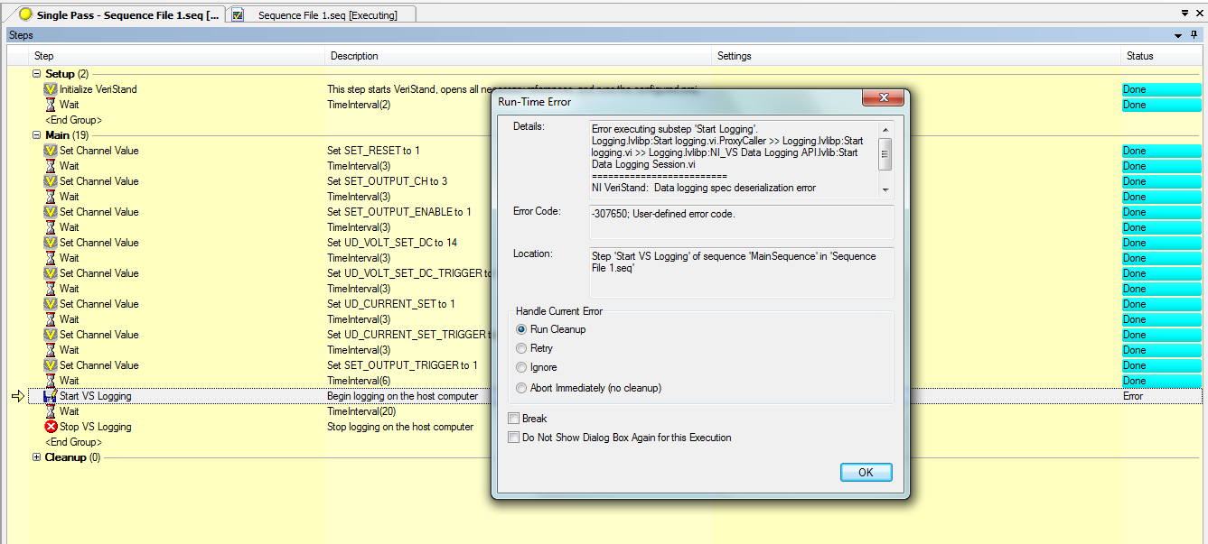

Hi Andy,
When executing a Teststand Sequence developed in a different computer, "Start VS Logging" step does not work.
The attached images shows the details of the error.

Hi WMohsen,
I'm not completely sure about this problem, but I'm wondering if you may have different vesions of the VeriStand Custom Step Types installed on each machine.
Can you let us know which versions of VeriStand and TestStand are installed on each PC?

Thanks Andy-C for the quick response.
I am using Veristand Custom Steps version 2.3.1.
I've updated the Veristand Custom Steps in my PC to match the version used in the development PC.
The problem is solved!
