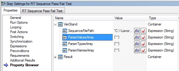

Hi all,
I've faced the same problem ofwierlo_1. I've found that the problem is related to the way the configuration dialog box of the custom step react to a realtime sequence whitout parameters. In this case the Step.VeriStand.Param___Array assume the value of {""}
Then, at run-time, those parameters are passed to the VI that launch the realtime sequence (ie "Run RT Sequence Pass Fail Test.vi") as arrays with a single empty string instead of empty arrays.
This empty string is interpreted as a "Default" parameter so the "Parameter Assignments" array passed to "Create Sequence Call.vi" contains an invalid element and cause the error.
A quick fix is to enable the "conditional" on the auto indexing terminal that builds the "Parameter Assignments".
Hope this will help 🙂

Hi wielro_1 and D4N!3L3,
We finally had a chance to finish fixing the RT sequence parameter issue. My apologies for the delay.
I just posted an updated version of the installer for VS 2015 SP1 which should allow you to run RT sequences without any parameters. We updated the code with the same change D4N!3L3 suggested.
