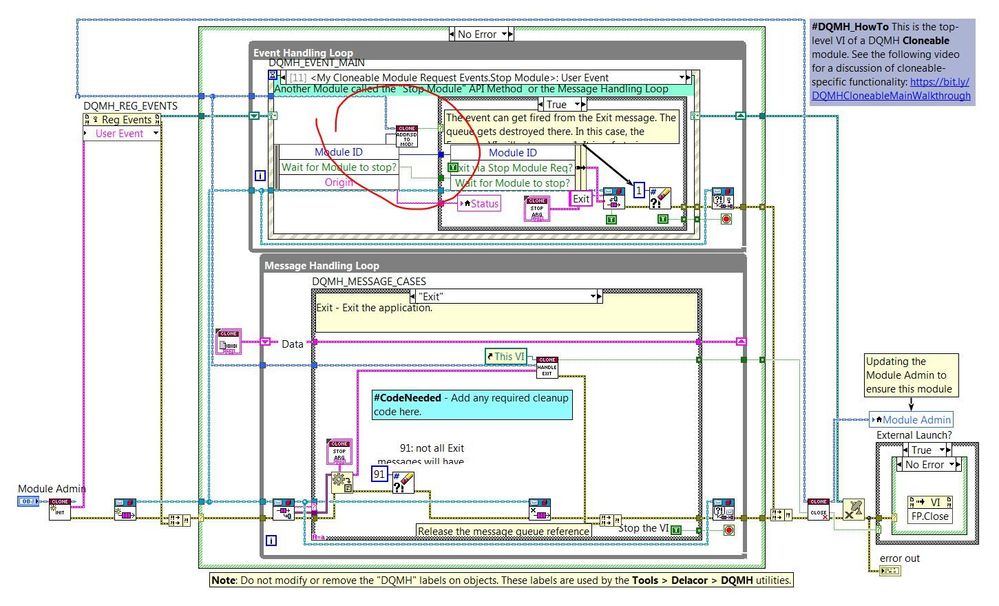

The difference between the singleton vs clone-able modules at a high level I think is a slight performance/memory gain.  The clone-able modules have more extensive initialization code than the singleton and also differentiate between events meant for them versus other clones as seen here.  The singleton modules are also not re-entrant.cloneable.JPG

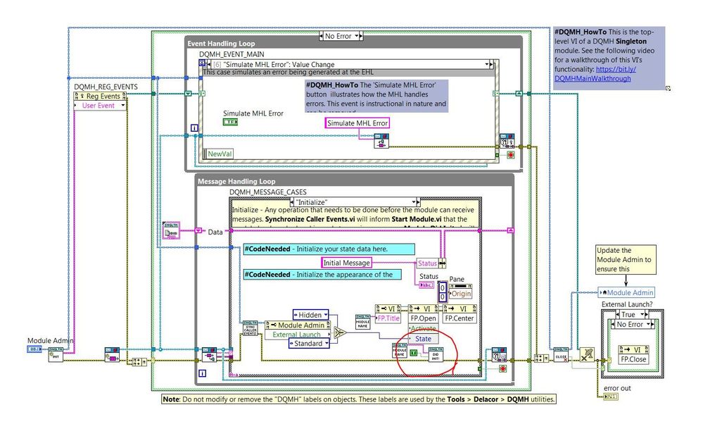

Modules themselves do confirm back that they have started as a part of the framework however the one caveat is that this is done as a part of the module Main.vi which means a user could conceivable remove this functionality if they did not know what it was for.start init.JPG

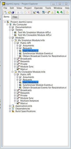

  • Simplicity: It is a lot easier to explain how DQMH modules work using the DQMH Singleton module. Managing the clone IDs add extra complexity to the code. If all the programmer wants is a module that is accessible in different parts of their program, they can call Start Module.vi as many times as they want and they will always get the same instance.

Blackburnite also made some good observations on his post above regarding the differences. Blackburnite said "Modules themselves do confirm back that they have started as a part of the framework however the one caveat is that this is done as a part of the module Main.vi which means a user could conceivable remove this functionality if they did not know what it was for."
There are several things in the Main.vi that could cause the module to not behave as expected, however, we expect that LabVIEW programmers will be using the DQMH API Tester to launch and test their code. The scripting tools even encourage the programmer to keep their DQMH API Tester up to date. A DQMH out of the box does three things very well: "Starts when we tell it to start and reports back immediately, reports errors to DQMH API Tester (or stops in error if running as a stand-alone), stops graciously and immediately". If the DQMH module stops doing any of those three things, then it is something the programmer just did. Running the DQMH API Tester after each new event has been created or new features have been implemented will ensure that the programmer would know immediately that they removed something they shouldn't have removed.
