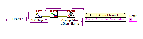

I am trying to identify my different input channels of the PXI I am using and I would like to use the "General Properties:Description" field to do it. The problem seems to be really simple but I cannot find how to write this field...Capture.PNG
How can I modify it? It always generates void when I set a description in the channel constant VI or in the create channel VI.

To write to a property in LabVIEW you need to right click on the property node, and select 'Change All To Write'. By using this property in write mode, a description for each channel can be set, which can then be extracted using the same property in read mode.
See the attached screenshots for reference.

Thanks for your help. That's what I thought after a while.
At the very beginning I asked this because I thought "General properties:Description" output what you write in Description and Tip (when you right click on Create Channel vi.). But no, it actually outputs what you previously set on "General properties:Description".
Thanks indeed.
