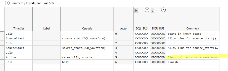

I have attached a minimal Digital Pattern Editor project that should help to illustrate the problem.  This defines two buses of 8 pins each, DQL and DQU.  Each has its own source pattern (one counting from 0-15, the other counting from 15-0).
These buses have the same size, so I have eliminated that as the source of the inconsistency.
The documentation says that up to 512 source waveforms can be loaded at once, but I can't even get two to work.  Can someone take a look at the attached project and see anything I did wrong?

I think you have got a misunderstanding of how source waveforms are implemented on the FPGA within 657x
You cannot have two simultaneous source waveforms in the same vector, the idea of multiple source waveforms are across different vectors. For example, for the first half of the pattern you might want to use a source waveform, then in the later part switch over to another source waveform. The opcode source_start sets the currently active source waveform and only one source waveform can be active at a moment.
If you need to source some data in a vector, all data have to come from a single source waveform - this is my understanding, this is because I could not think of a simple way of FPGA implementation that can handle references to two or more source waveforms at the same time.
If you need a firm answer, please reach out to NI support.

Based on your implementation, I would assume that you have got a lower byte bus and upper byte bus, you can easily combine these two U8 into U16 and write to a single source waveform. What do you feel is a challenge or difficulty in combining them into a 16-bit wide sample instead of two 8-bit wide samples?

To be clear, the example I posted was created as a simple way to generate the error message I was getting while still having two "consistent" source waveforms.  This isn't exactly representative of what I was trying to do.
You said that you thought only one source waveform could be active at a time.  However, the Digital Pattern help documentation says "You can load up to 512 source waveforms on the instrument at a time." (Instruments -> PXIe-6570/6571 -> Source and Capture -> Source).
I think I'll contact NI support.  Thanks.
(1,682 Views)
You can 512 waveform definitions to the instrument but while executing only one will be used at any point in time.
It is like you can park 512 cars in your garage but you can drive only one car at a time.
