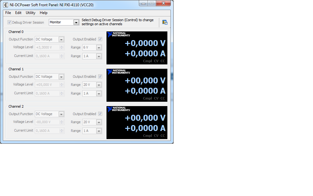

Good day,
i would like to use SFP (soft front panel) of our DCPower PXI4110 inserted into PXIe 1078 chassis with PCIe connected to external PC to monitor the orange led of ch2.
Apparantly, i get no values. What I'm doing wrong ?

I don't know what happened, but now it works fine.
Only, though, when You open the SFPs after You allocated the channels with Your own to log application.
Then, note that the 'Debug Driver Session' check box is automatically checked with drop down box filled out with 'Monitor'.
I had also installed labVIEW 2015 DS2 and lots of drivers (NI update service totally notify free....).
